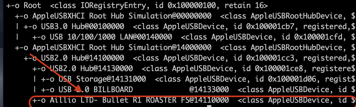

HI there, My Mac isn’t recognizing when it is connected to the bullet.
I’m using the latest MacOs Software on a MacBook Pro (13-inch, 2017, Two Thunderbolt 3 ports).
I’ve uninstalled, reinstalled, tried a variety of startup configs - plugin in then start, start then plug-in, etc.
I think it may be something with the bullet board not outputting? Is there any way to reset things on the board?
Any other reasons why Roast-Time won’t recognize being connected?
I just got the bullet in Jan and haven’t been able to use RT with even a single batch yet.

If you could find someone with another laptop or mac to try it on that would be helpful. The USB is tested from the factory, and we have never seen a USB connection be damaged so it seems unlikely - but of course not impossible.
If you connect it to a windows computer it should show up in the device manager.
